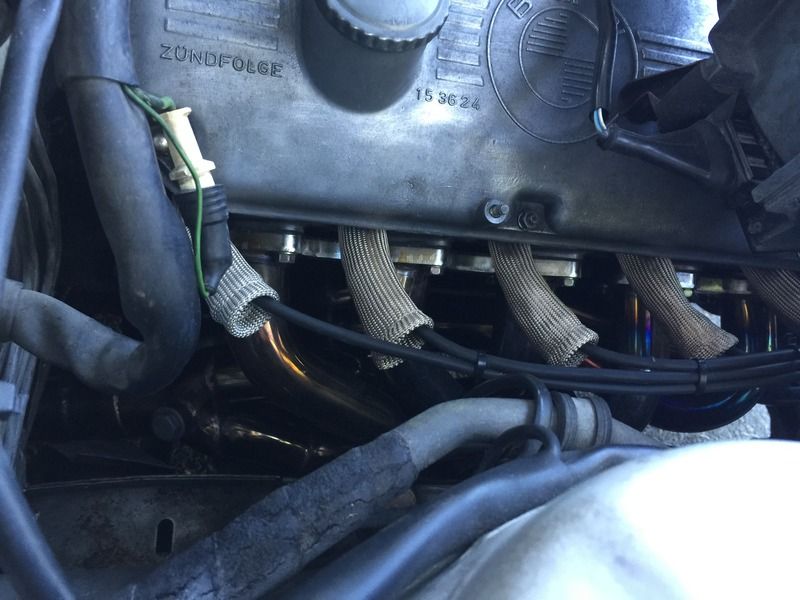

Re: 1985 BMW M535i (euro import)
There were two motors.
10:1 compression without a cat
8:1 compression with a cat.
In your photo of the engine, I can see the o2 sensor connector in the harness, so you have the 8:1 with a cat. VIN should start WBADC51...
That green wire is the signal wire for the o2 sensor. 10:1 motor cars don't have o2 sensors.

Yes, except it's not hooked up to anything, the harness is the same regardless of engine type. This is a DC61 per the vin. Thanks!
You're wrong as 10:1 cars with the 061 ECU don't have that. DC61 means it started as a low compression automatic, so the manual transmission and related parts are not original to the car.Blairwershler wrote:Yes, except it's not hooked up to anything, the harness is the same regardless of engine type. This is a DC61 per the vin. Thanks!

Forgive me i stand corrected. The car is a dc51, so LHD manual with catalyst. However it's running an 061 Ecu since importation, so no O2 sensor. I suppose that means there is a possibility it's had a high comp motor swapped in, but not really sure how to verify this. Thanks for the info
