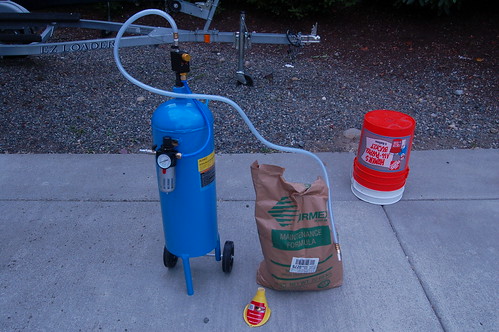

Q: What's the best way to clean caked on grime and cosmolilne off aluminum and plastic parts?
A: Soda blasting! Careful on the plastic to use a mild grain soda because it WILL make the plastic slightly more matte.
Before:
After:
A few minutes later:
DO NOT USE A SAND OR MEDIA BLASTER FOR INTERNAL ENGINE PARTS. Those kinds of media will never come out and they will do what they were designed to do (abrade) when the engine runs.
