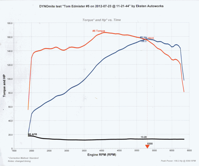

dynoed at 148whp at 5150 with chipped motronic 1.0

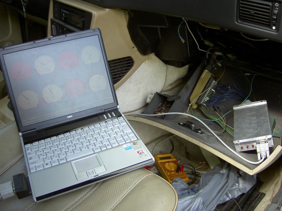

The MS is connected to a 35-pin Bosch connector, early version of the harness seen here:
Only the wiring for the VR sensor and IAT was run separately.

Dyno:

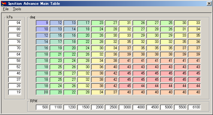

There was a modest power gain. But the VE table needs more work, as it was too rich at 3500 for instance. I have picked up a few mpg with MS, managed to hit 30mpg highway. Tables used for the dyno run:

I swapped the stock ECU back in to check the fuel rate output signal (pin 11) with a scope. It seems that the line is pulled up at the instrument cluster, the ECU just grounds it for a period of time when the injectors fire. I am going to try connecting it to one of the injector outputs on the MS and see how that goes.
