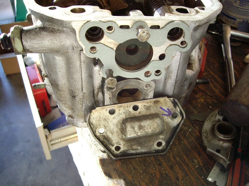

I know it doesn't come up everyday, but it's regular enough that someone is trying to figure out where the seal on the rear cam cover goes, and maybe even why. Hopefully this pic will illustrate that, the arrow shows where and the picture of the head with the gasket not surrounding that one bolt is why. I figured since I was doing a head anyway, I might as well take a pic.
