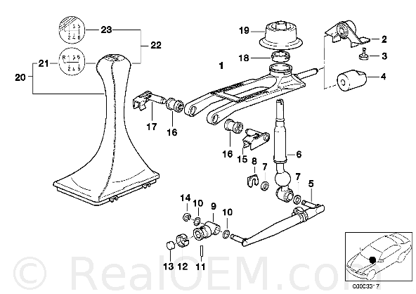

You should be able to figure out all the part numbers you need from what is described above, and order them from autohausaz.com, pelicanparts.com or bavauto.com (or even your local dealer if you want to pay dealer prices).BigMac wrote:Is there a place to purchase all the items needed for the Z3 shifter upgrade?

Thanks.WVe28 wrote:You should be able to figure out all the part numbers you need from what is described above, and order them from autohausaz.com, pelicanparts.com or bavauto.com (or even your local dealer if you want to pay dealer prices).BigMac wrote:Is there a place to purchase all the items needed for the Z3 shifter upgrade?

I actually feel like an idiot right about now. When I originally looked at the diagram I didn't even realize that it specifically told me which parts I should replace.

Just noticed something with the order of parts for the Aluminum console.
The RealOEM diagrams are not consistant, but normally the list of parts is correct.
To connect the selector rod, the parts list and the diagram shown here, show 2 yellow plastic washers at one end, and 2 orings with a steel washer at the other end.
But the photograph, shows yellow washers at both ends without the Orings.

Tyler: Are you talking about the dowel pin #17 in this diagram?tsmall07 wrote:Has anyone mentioned that part #17 should be replaced with the metal pin found in the 8-series cars? That adds a little longevity to the linkage.
That would be #11 in this diagram from the e31...
If so, that's part #23411466134, which cross-references to the same part on the e28 (and what looks to be every other model sporting a manual trans..)

Quick question on this topic...
I am trying to get the gear linkage back to a normal state, as is real loose.. however while looking at the diagram posted here, i like to make sure this also applies to an Alpina B9 3.5s from Europe...
I am entering the VIN into Real OEM and matches with the exact diagram posted here, but while browsing trough the part numbers realoem says the parts listed are not compatible with the VIN given...
any ideas?
any ideas?
