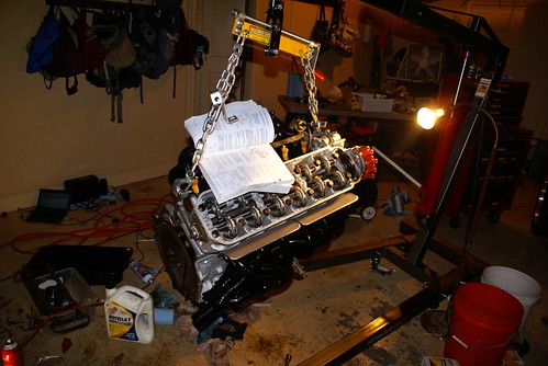

...and now my M30 is sitting on my garage floor.
The plan for the moment is to go ahead and get head/valves done at a machine shop, do a stock-ish rebuild of the top and bottom ends, fix the wealth of vacuum and electrical issues I had, clean it all up, and drop it back in with new headers. I'm relatively mechanically inclined, but not very experienced with this sort of thing. I have a friend helping me out that knows much better what he's doing, but I definitely would like all the help I can get.
More pictures:
2012-07-09 18.23.18
2012-07-09 18.26.33
2012-07-09 18.26.45
^ in pulling the motor we smacked the front against the front bit of the radiator and scraped off a little paint. whoops.

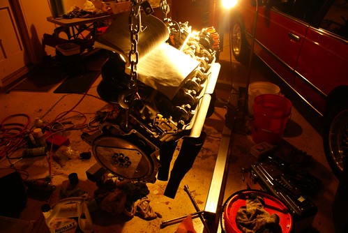

we dropped the pan to get a socket on the torque converter mounting bolts. I think we did this wrong: took the transmission off without taking the torque converter with it. thoughts?
2012-07-10 23.59.02 by seewhereweland, on Flickr

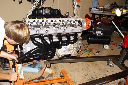

headers!
2012-07-17 01.29.01 by seewhereweland, on Flickr

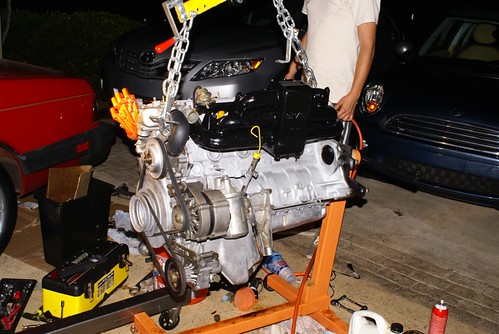

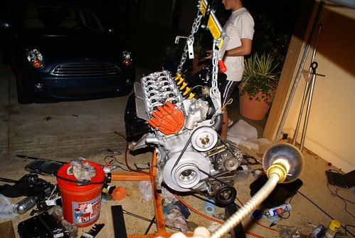

Picked up some bits and pieces (bolts, brackets, etc) at pull-a-part this morning, reinstalled most of the accessories and the exhaust. Got the engine off the stand and onto the hoist to prep for reinstallation of the transmission. Pictures:
2012-08-09 22.01.12 by Marshall H, on Flickr
2012-08-09 22.02.00 by Marshall H, on Flickr
2012-08-09 22.02.12 by Marshall H, on Flickr
2012-08-09 22.20.41 by Marshall H, on Flickr
2012-08-09 22.21.00 by Marshall H, on Flickr
