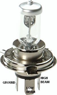

Here is a picture of a typical H4 bulb. It has 3 prongs and I have labled their role:

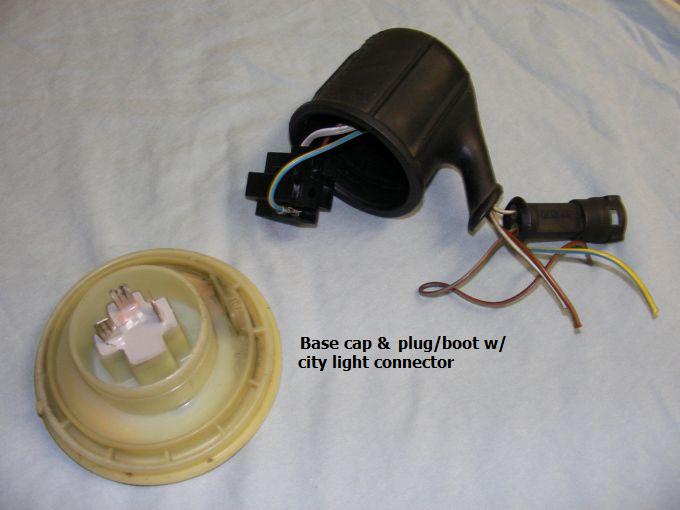

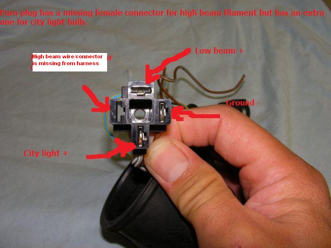

Here is a pic of the plug/harness. You can see the wire for the high beam is missing-deleted. We just need to add that in!
I’m sure there are tons of ways to modify the plug but this is the route I choose to make everything look OEM.

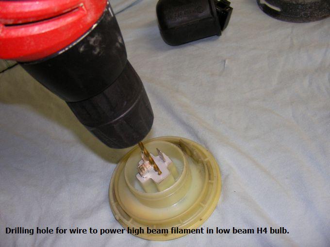

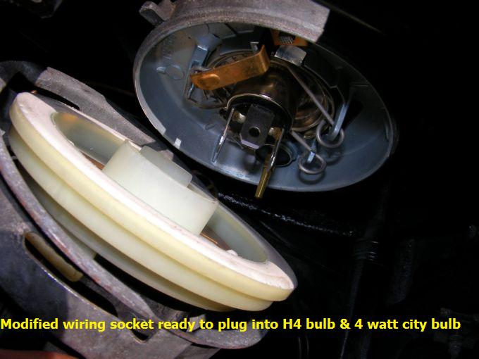

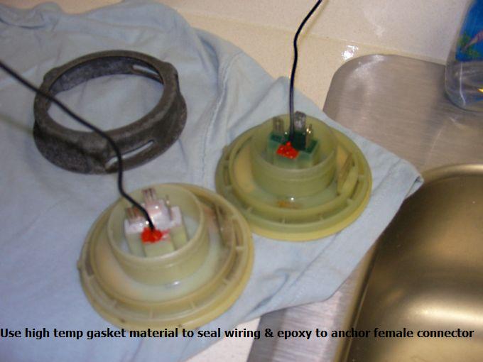

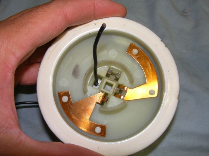

1. You will need to take the white plastic base harness connector and drill a hole to accommodate a 16 or 18 gauge wire to power the high beam filament.

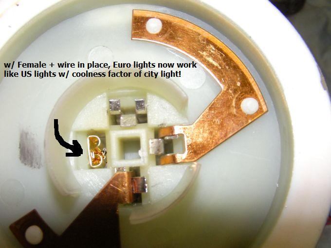

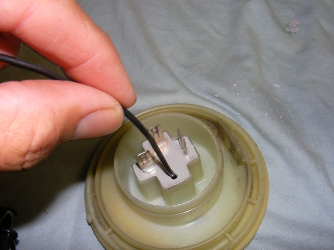

2. Pull wire all the way thru and crimp a female connector on the bulb side and male connector to other end.
3. Here is what it looks like on the bulb side.
4. Once a female connector is crimped, push it back into the recessed are of connector. I used electrical epoxy to keep it in place. Make sure it is perfectly even with the other female connectors

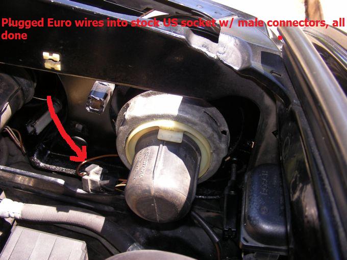

You are almost done! Feed the wire right thru the black plug. all the connections of the harness should have male connectors crimped on them and should plug right into the OEM headlight plug. The city light wire should be spliced with the front left parking light + wire so they come on when parking lights are on.

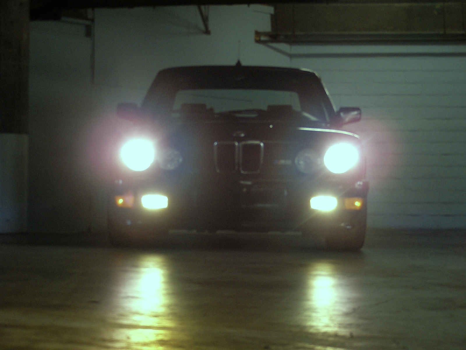

CITY LIGHTS ON- ONLY
HEADLIGHTS AND FOGS ON
FOUR HIGH BEAMS ON - 420 WATTS OF CANDLE POWER!
