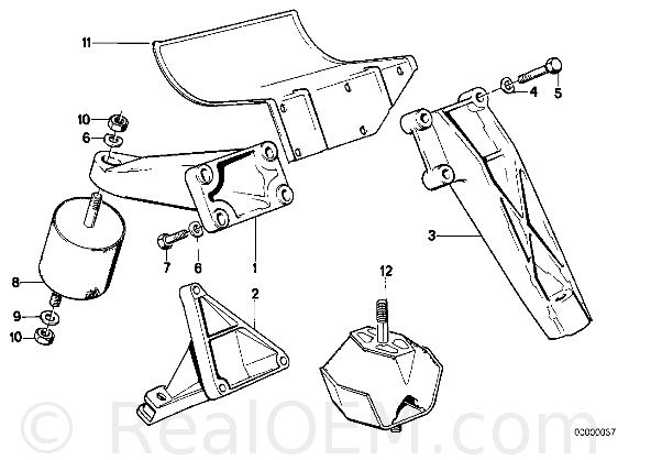

I would appreciate some help trying to figure out how to swap a b35 into my US spec e23 (1986 735i) because right now the engine is not sitting straight.
I already bought the Left and Right Koala engine mount adapters, but when mounted the engine still looks crooked. The passenger side adapter worked perfectly, but once you try to mount the drivers side, things get weird. Since this is an e23, do I need to order the driver side engine support bracket too?
Here's the 2 Koala adapters I bought so far... (I borrowed the picture below for the Interwebz... I do not have the other engine support bracket in the picture)
Here's how crooked it sits...
Here's a pic of the driver side Koala adapter....
Here's a pic trying to use the existing e23 b34 mount...
e28 535i driver side engine support bracket #3. Is this what I need (11811175591) to make it fit into an e23?
