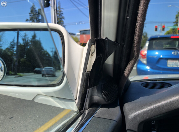

So, I have made as many repairs as I can on the felt window /door trim as I can. The current state of appearance bugs me and I want to replace it. Part 51 72 1 904 328. I have found it listed for sick money. I am sure someone here has found either an alternate item or a better source.
Any suggestions?

I wish I knew. I just glued mine back in place but I'm sure it was come aloose again.... Also do you know how to obtain the hard rubber pieces that go inside the window frame? I'm missing one of the ones that goes in the corner by the tweeter after a pick and pull replaced my driver's window after a break-in. Good luck.

I was thinking that junkyard felt from an E38 would be worth a shot. Cut it down and hide the seam under the door sill trim. That was my intention to try. I have maybe 2 good sets of trims at home so I'm not in a rush but I did forget to bring a trim piece home from the yard the other month. Doh!

I just removed all the felt from my car. Looks better then sagging felt everywhere.

Seattle Guy, you need the inner door rubber. It's one piece. A yard car without damaged inner door window guide rubber would be good or buy new. You can find part numbers on realoem. Best

Solid. This guy: I thought it was 2 pieces in there. Thanks for the info. I have a passenger door so I'll see if they are LH/RH specific.Spen wrote:Seattle Guy, you need the inner door rubber. It's one piece. A yard car without damaged inner door window guide rubber would be good or buy new. You can find part numbers on realoem. Best

The seals are the same diagonally. RF/LR, LF/RR.

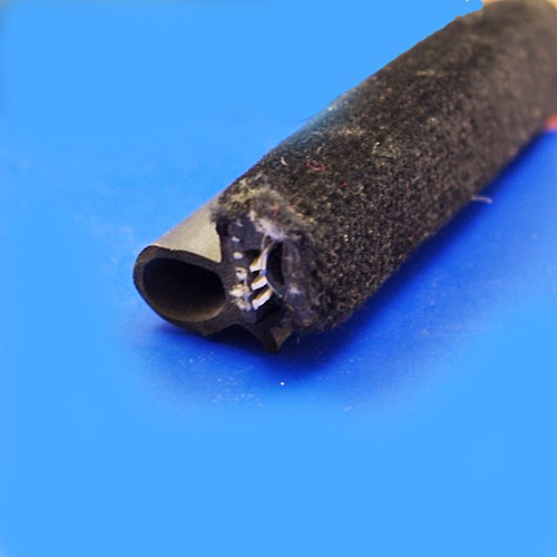

The generic name for those seals is
FURFLEX DOOR SEAL
I haven't bought any myself, so I can't recommend any vendor.
This is nice too:
https://www.ebay.com/itm/New-Fuzzy-Furf ... 0905041123
It uses a flock layer (or is the rubber flocked directly?) and looks very tidy.

This is close too:
https://www.vintagecarparts.co.uk/produ ... t-excluder
What we really need is this "windlace" fabric ( 1/2 woven, 1/2 plush)...
...but glued to a door seal instead of a rubber tube.
The materials exist, but the E28 combination doesn't seem to be readily available.

https://gummi-metall-puffer-shop.de/kan ... ours-wolle
This is the one i found in germany.i'm going to order soon for the front. I will report when it will be on thd car.

I ordered a sample from:
Thanks Sagi.
It turned out great, not quite exact copy but close enough, the fur part goes all the way round so no cloth part. Fine by me.
You would have to 90 degree the corners of course but not an issue.
Well made quality seal with aluminum core like original.
See pics via Dropbox.
Thanks Sagi.
https://www.dropbox.com/sh/1gm1ew5g2zr3 ... el81a?dl=0
Dave

I calculated 11 metres total for all 4 doors which gives a few CM spare. Plan on cutting at 45 degrees and gluing in place for the top rear corner. It will look like the factory one.
If you are not sure than an extra metre is not going to break the bank.

cek wrote: Jun 24, 2020 2:17 PM Earlier this year I had Ivo buy 11 meters of this for me, which I transported back from Amsterdam in my suitcase:
(From this thread: viewtopic.php?p=1477709#p1477709)
First step was to see how the short corners could be made to work. It took several attempts and I finally settled on this: Two 45 degree cuts using some Swis shears. Kohler suggested cutoff wheel might work even better. I'll try that for the right side.
I did the driver's door first:
Then the left passenger door.
I'm extremely happy with this stuff. There's a very small risk of water ingress at the corners where the cuts are needed, but if the door seal is in good shape, this should not be an issue. Some gasket maker, carefully applied might seal it up, but I'm not doing that here unless I know I have to.
This stuff is a bit bulkier than the OE stuff. The doors close fine, but you can tell its a little tighter. The B pillar covers fit on tight.
