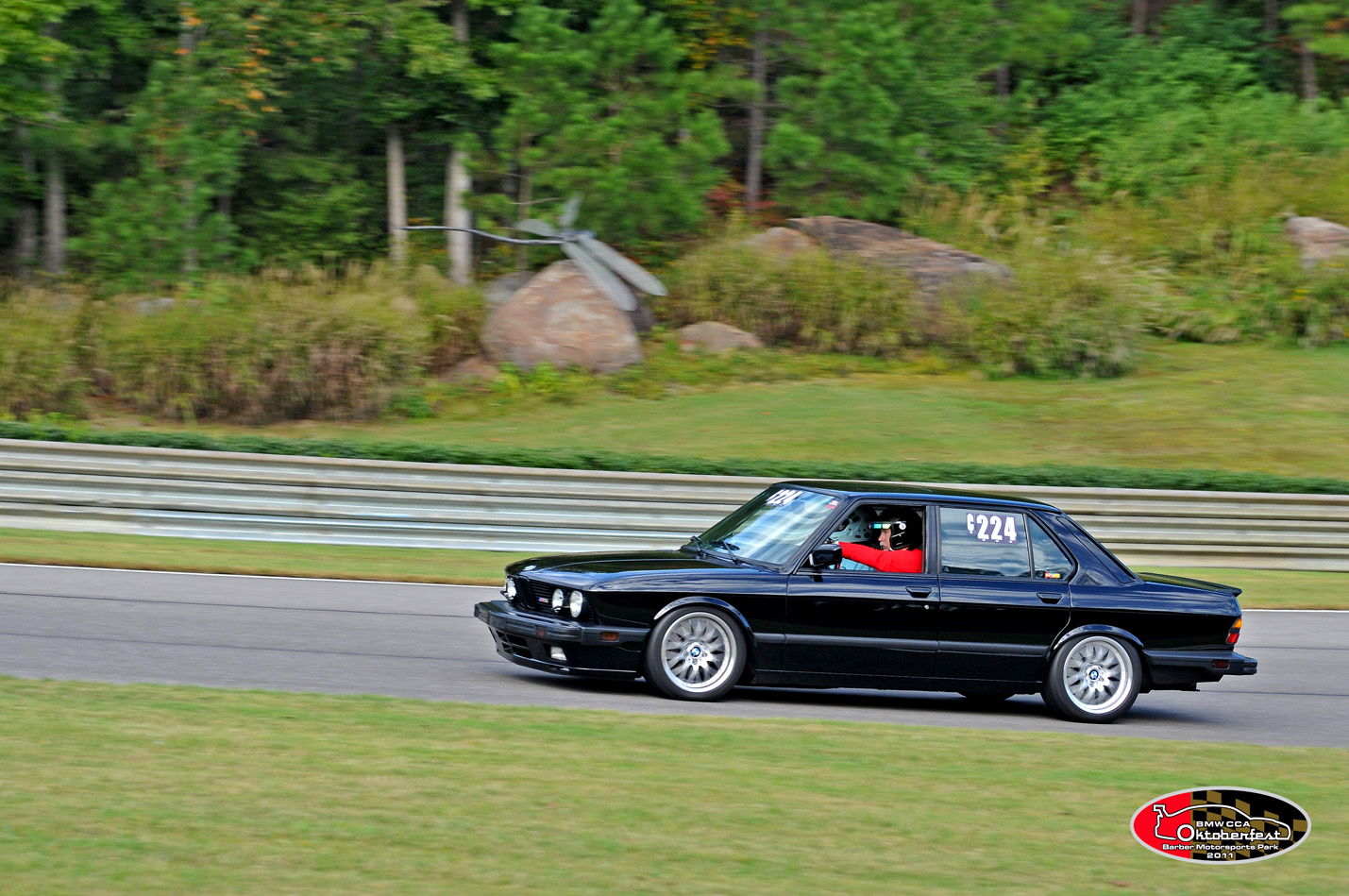

Gee Matt thanks for the compliment.Matt wrote:IMO Gary Beck's S38B35 should be the new "formula" for E28 M5 builds.. i.e. anyone that plans on doing anything with the motor outta just do what he did. Save money by leaving the ports/head and valve sizes alone. It's all factory parts except the standalone management and the hi-comp pistons..
I went to Ofest this year since it was in Birmingham AL just a 2 hour drive.
I was brave and did a one day DE at Barber Motorsports track.
Since track time is how this engine rebuild got started (burned piston) I was pretty hesitant to go out.
After a few laps and watching the AFR gauge my confidence rose. The car ran flawlessly and by the end of the day I was doing some pretty good laps. No one was passing me. LOL
Of course my ride in the McLaren race car was the highlight of the race track time.
In the end though the M5 is just to nice to have a boo boo at the track and make a mess of it. Need a dedicated track car.
Gary
Gary,
I came to the same conclusion about not wanting to wad up the M5.
Ironically, a few years after I retired my M5 from track duty, some asshole rear-ended it. I still havent' found a body shop that is excited about fixing it.
So i have all the BMW parts to fix it sitting in my garage, but it remains, broken
I definitely recommend getting an E30 track rat. Too cheap, too fun.
Or stupid..........Philo wrote:That's one nice track car.. Very Brave Gary !
One thing about the Barber track is that it is not too fast.
Not real long straights and the guard rails and barriers are pretty far off the pavement so spinning out would not necessarily total your car. Of course hitting another car could be a problem but I'm in a C group of mostly amateurs so we are not that close together thank heaven.
Matt, I sure hope you can get it fixed. Maybe some shop will be slow in the winter in your area and want some work.
